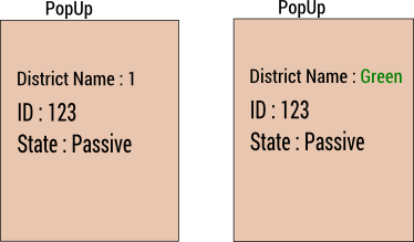

I am developing an app that uses QueryTask feature of Esri Android SDK. Evertyhing is perfect except one thing. QueryTask results return Attribute Values and I am displaying this values at Popup. Let me explain deeply. Results have district field. I use district_name with coded value. For example; When value 1 district name display Green, when value 2 district name display Blue. At the SDK side, I am able to show district name =1 or district name=2. I want to show real district name with CodedValueDomain.
I showed like left popup my attributes but I want to show like right popup. I dont know how to access codedValueDomains. I've read API documentation, samples etc.
