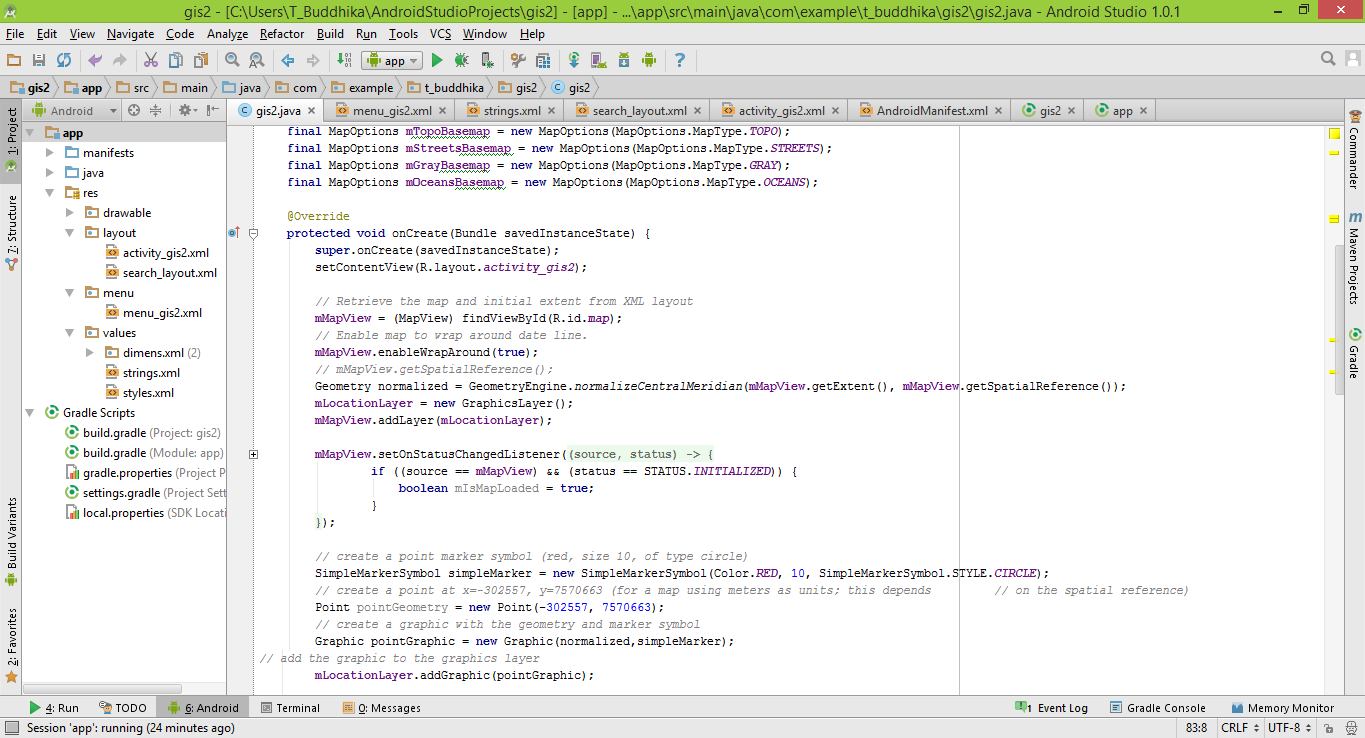

I'm new to ArcGIS runtime sdk and i want to add simple markers on the map.. So i tried the guid-> Display Information -> add graphics and text codes and before that i made the map by referring guid -> Tutorials -> Use ArcGIS base map.
After run this on my mobile device i got the error as follow.
Error is on the  Geometry normalized = GeometryEngine.normalizeCentralMeridian(mMapView.getExtent(), mMapView.getSpatialReference()); line.

     Caused by: java.lang.IllegalArgumentException: Input geometry can't be null.
Please help me on this. Thank you very much.
ShellyGill1
Hi,
I think you should move your normalizeCentralMeridian call (and everything that depends on it) to your onMapStatusChanged event after you check for the status INITIALIZED - the map only has an extent and spatial reference set once it's initialized.
