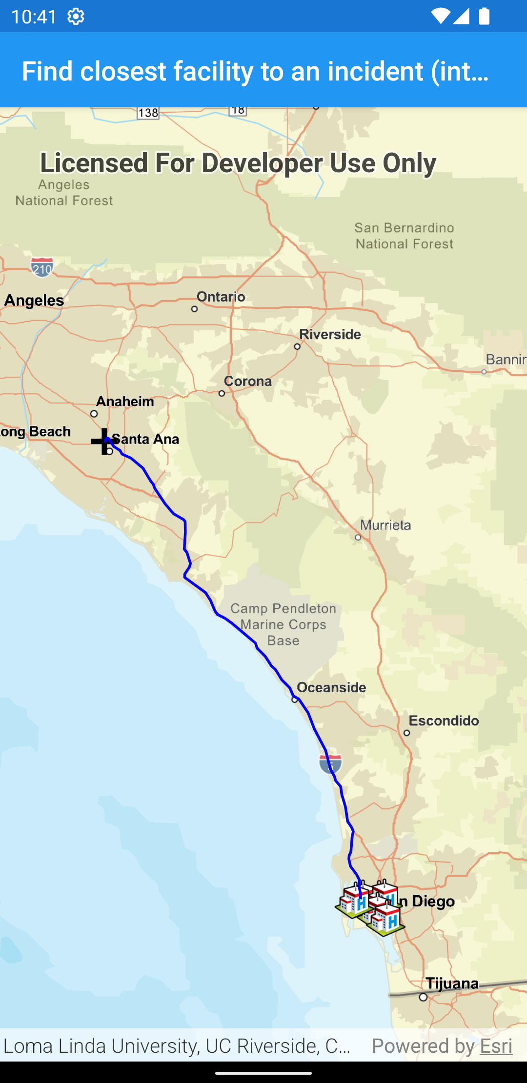

So apparently I'm still getting some strange bug.
So I tried changing from the San Diego closest facility service to the generic one.
Everything worked well for the San Diego area, but as soon as I was outside San Diego, I got an error saying 'Incident not within the San Diego Area!'
I don't understand since I'm not using the San Diego closest facility service but rather the normal one.
<string name="san_diego_network_service_url">https://sampleserver6.arcgisonline.com/arcgis/rest/services/NetworkAnalysis/SanDiego/NAServer/ClosestFacility</string>
Generic Closest Facility location service.
<string name="closest_facility">https://route-api.arcgis.com/arcgis/rest/services/World/ClosestFacility/NAServer/ClosestFacility_World</string>
I changed from
mClosestFacilityTask = new ClosestFacilityTask(this, getString(R.string.san_diego_network_service_url));
To this
mClosestFacilityTask = new ClosestFacilityTask(this, getString(R.string.closest_facility));
Thus, for some reason, I'm apparently still using the San Diego Closest Facility service because it says I'm outside San Diego. Or something else that I'm missing ..!
P.S. I used the code from this sample
Cheers
Please ignore the error.
I realized the code was written to output that SanDiego message no matter the error.

One interesting phenomenon is that by checking my ArcGIS for Developers dashboard, I can see my account is consuming the Closest Facility service thus the error could be in handling the result.
Hope I was clear and I'm sorry for the confusion
You are seeing the error 'Incident not within the San Diego Area!' , because you are still getting the unable to complete operation from the service and hence the toast message hardcoded in the sample,
I just tried switching the sample to use generic Closest Facility location service and that seemed to work fine with the sample for me using my API Key
