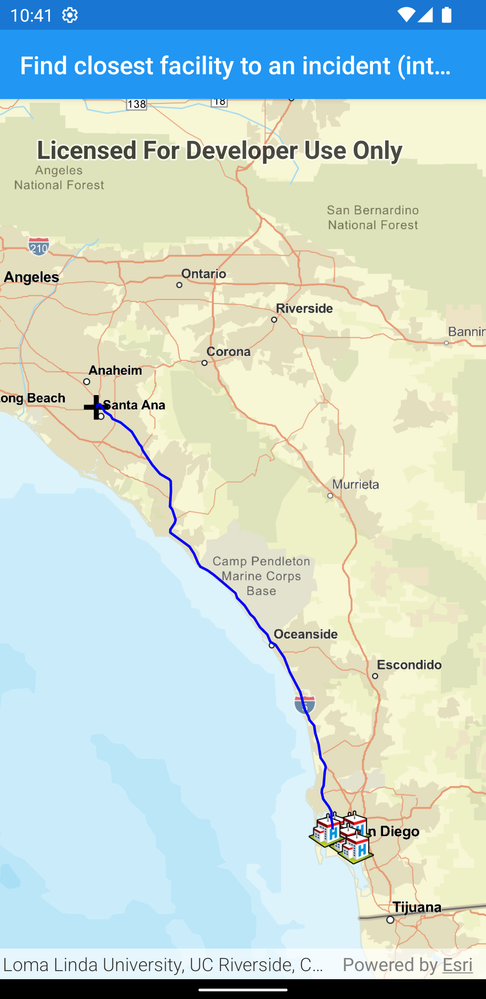

So apparently I'm still getting some strange bug.
So I tried changing from the San Diego closest facility service to the generic one.
Everything worked well for the San Diego area, but as soon as I was outside San Diego, I got an error saying 'Incident not within the San Diego Area!'
I don't understand since I'm not using the San Diego closest facility service but rather the normal one.
<string name="san_diego_network_service_url">https://sampleserver6.arcgisonline.com/arcgis/rest/services/NetworkAnalysis/SanDiego/NAServer/ClosestFacility</string>
Generic Closest Facility location service.
<string name="closest_facility">https://route-api.arcgis.com/arcgis/rest/services/World/ClosestFacility/NAServer/ClosestFacility_World</string>
I changed from
mClosestFacilityTask = new ClosestFacilityTask(this, getString(R.string.san_diego_network_service_url));
To this
mClosestFacilityTask = new ClosestFacilityTask(this, getString(R.string.closest_facility));
