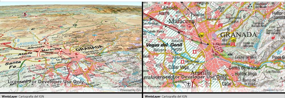

Hello again! I have some updates.
The reason Runtime had trouble loading this service is: this service specifies SupportedCRS of the default tile matrix set ("InspireCRS84Quad") in an unusual way. It is declared as http://www.opengis.net/def/crs/OGC/1.3/CRS84 instead of the usual CRS84 or CRS:84 or urn:ogc:def:crs:OGC:1.3:CRS84 formats. I've only seen this pattern on newer OGC-API-Features services before, never on WMTS. Future versions of Runtime should be able to parse this rare format too.
The workaround is to use a WMTSLayer constructor that takes a TileMatrixName. Other tile matrix sets on this service do not have the same problem.  For example, you can use "GoogleMapsCompatible" in a WebMercator map (it looks best) or "EPSG:4326" in a WGS84/Plate Carree map.  I was able to get this service working with Runtime 100.14.1 in both SceneView and MapView:
Please let me know if this solves your problem!
