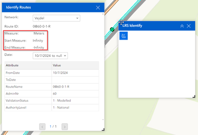

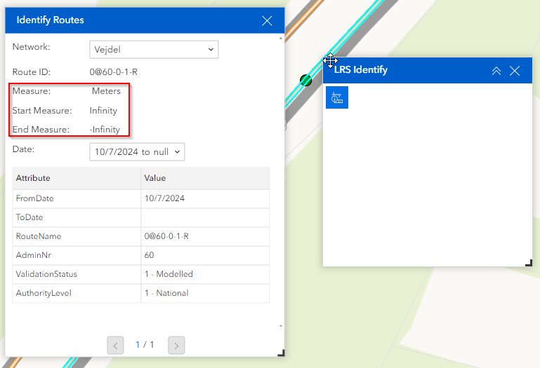

We have been building a Experience Builder App with the new Roads and Highways widgets released with Enterprise 11.3. Using the Identify Routes widget gives an unexpected result:

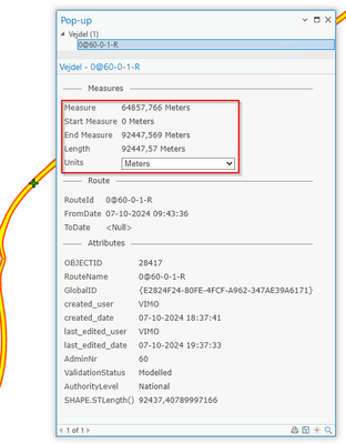

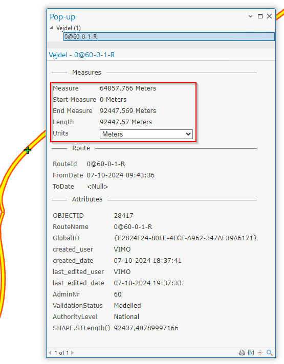

It is not able to give us the Start, End and Current measures for the selected route. When using the same tool Identify Routes in ArcGIS Pro, on the exact same dataset, it is showing the measures:
In ArcGIS Pro (3.3.2) i tested both on the feature classes in the enterprise geodatabase and the published feature service - both are working.
The Experience Builder widget has worked before - but seems to be very unstable. Since a few days it doesn't matter which browser I use - Google Chrome, Edge, Brave, Safari - none of them can show the measures.
I don't know where the issue is coming from. Has anyone any thoughts on this?

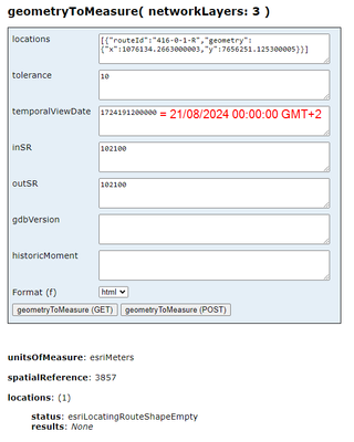

The solution for this issue is a correct conversion of datetime to a unix timstamp before appending routes. Unix timestamps don't contain information about time zones and is per definition in UTC. Our data is in UTC+1 (or UTC+2 during Daylight saving time), but were converted to a timestamp, without first convert to UTC time. The results is that the Experience Builder App is asking for a GeometryToMeasure 1 (or 2) hours before the route was existing and returns a RouteShapeEmpty error.

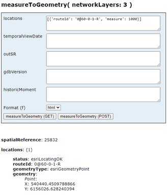

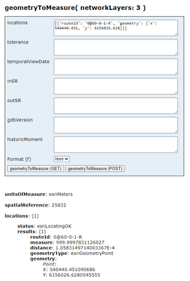

@AyanPalit Thanks for your quick response.
We are using these services and they work fine. Here are two screenshots which shows that both geometryToMeasure and measureToGeometry are working:

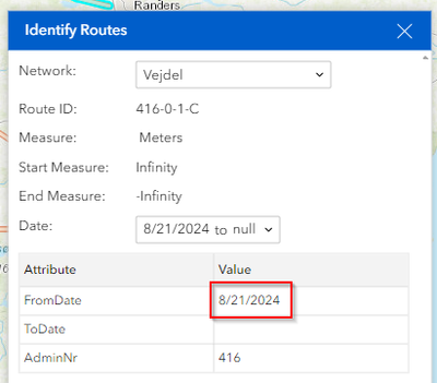

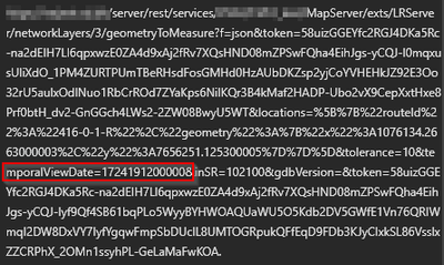

@AyanPalit  I have run some tests and checked the browser developer tools. I found something suspicious. - the widget is using the geometryToMeasure service, but when inspecting the url I found that the TemporalViewDate parameter is set to the FromDate value of the object. Should the TemporalViewDate value not correspond to the current date and time?
