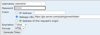

The first is that even though we are able to obtain a token from the Portal URL shown below, we are still getting prompted to sign in when our app loads even thought the token is supplied to the same code above when calling the "registerToken" method above. We are not sure if we have to switch to oAuth here and if so, while we could do it, our vendor supplied products, at least in the current form, won't be able to adapt.
https://gis.server.com/portal/sharing/rest/generateToken

So after making a call to ESRI support, we were able to resolve both of the issues mentioned in the original post, so I will post the answer to both items below.
For the item relating to token security, while the path to generate the token at the URL above was correct, the option for which "Client" method to use was not. We had been using the option for "IP Address" but were instructed by our ESRI support specialist to use "Webapp URL". With this option, you can be as granular or as open on your URL as you desire, so if you wish to access multiple map services/items in the same folder, you can stop the URL at the containing folder level, or drill down as deep as you need to the "Map/Feature Server" level.
