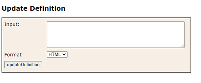

I am trying to edit a feature layer from feature server on our Portal with admin rest end point (which looks similar to this link  but with our portal web-addres):
http://services.arcgis.com/xxxx/ArcGIS/admin/services/Locations.FeatureServer/0
In many instructions it suggested to scroll down the page, click on 'update definition' and make required changes to provided html or json file. Example of the step is described in this article:
How To: Update the maximum record count for feature services in ArcGIS Online
I follow all the steps and get to "UpdateDefinition" page, but Input window is black. I expected to find there json or html file representing the current layer.
I need to update definition to reorder the points in the layer. Any ideas why nothing is in my input field?
thanks!

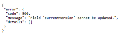

So I am on 10.7.1 and it did not work for me. Got the following error:
I was trying to add a subtype to a feature view though so might be trying to do too much. lol
Hopefully will work for you. Will be good to hear about the results.
RiceAdam
This is still the recommended solution for upping maxRecordCount and it's still not working. We're on 10.81 and experiencing this same issue:
This is after hitting the JSON file because 'Update Definition' still isn't working and only displays:
rather than displaying the JSON definition.
