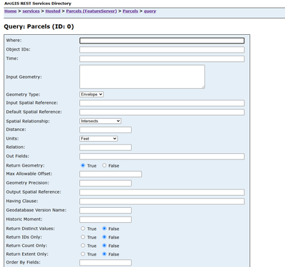

I am looking for some help with my first C# web application connection to pull some data out.
I have the all the sample parameters to make the call via the web based query page, I specified all the values needed, once I press Query (Get), I get the data and the fields/properties that I was looking for.
Now I want to translate all this to a C# web page to integrate in a web based application.
I want to leverage the data in there, but would like some help on a sample example that shows this done via C# web application.

when you say query get page do you mean something that looks like this?
When you do the query are you getting something below it like this:
(Indicating you have selected:
to HTML?)
ChicabowCheffy
Yes that is correct on all that you posted.
so how do I take all this and apply to a c# web application that makes the call to esri and gets the data returned and displayed to the screen/user

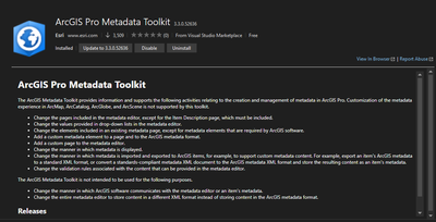

When I did that, I was actually embedding an ArcGIS map/webapp in an IFrame in the website we had setup, but its my understanding you ought to be able to render the maps as resources in a page just like any other source in C#.    When I recently updated my Visual Studio instance I noticed there were some out of the box functionality just for ArcGIS .  I was able to configure a search panel that would query two different arc GIS instances by address for example and return related records I could look at to create golden records for one of our department. (Golden record meaning it would have external agency and a snapshot of internal data so we could see who had what data, and whether it needed updating)
Some of the project templates may have some of what you need baked in enough that you can then make the changes you need.
It might be useful to look at the SDK and some of the extensions to see if any of them help expedite what you are building. I wish I could suggest a specific template type, but I haven't used them in several years, they may have changed.
