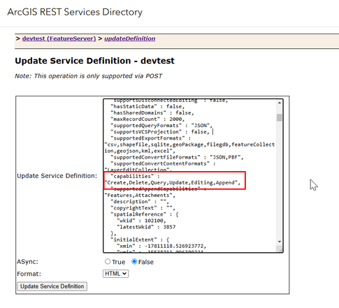

You need to add the append capability in your service.
Basically you can do it by the API with update definition and just add "Append" to "capabilities" to the service definition or go through the UI on AGOL:
AntoniGołoś
Thank you so much! Now it is working. It was misleading to see the
"supportsAppend": true
and having to manually add the operation to the list of operations, but now it works 🙂
