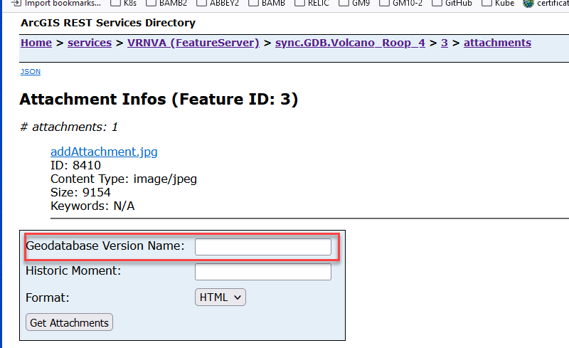

Hi @KarenRobine1 we are looking into this one. Note you can get attached features from a specific version using the feature resource.
For example https://myserver.esri.com/server/rest/services/VRNVA/FeatureServer/0/3/attachments
I hope that helps.
