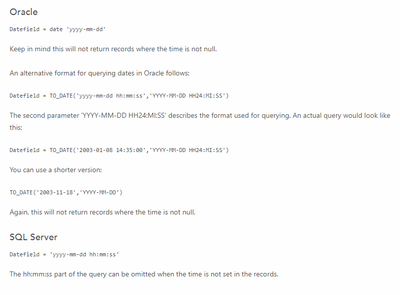

Usually these differences are caused by the requirements of the underlying database the query is being run against, but if that is the same in both the development and the production environments, then it might be because the 10.9 REST API uses the SQL-92 standard (see second image below.  It doesn't talk specifically about the REST API, but it mentions the 'date' keywork being required by SQL-92).
https://desktop.arcgis.com/en/arcmap/latest/map/working-with-layers/sql-reference-for-query-expressi...
file geodatabase use the "date" syntax

To add another to @KimberlyGarbade 's excellent post, we also noticed from 10.8.1 to 10.9 that our queries required the format "timestamp 'yyyy-mm-dd'", where before, the word "timestamp" was not necessary. I suspect that the underlying DB in the portal changes between versions.
