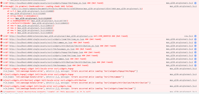

Hi All, i am trying to create a application Qlik Sense with ESRI using React JS application. Application showing Powered By ESRI message and maps are not loading. i tried  with Rest Api/ @ArcGIS Core/ Esri-loaders also. but same issue. Application is creating many bundles with related assets in folder. Can you please suggest me to get direction to resolve Map issue. Currently i am using Qlik Sense Desktop - 14.54.15 (with custom objects).

below errors i am getting:
