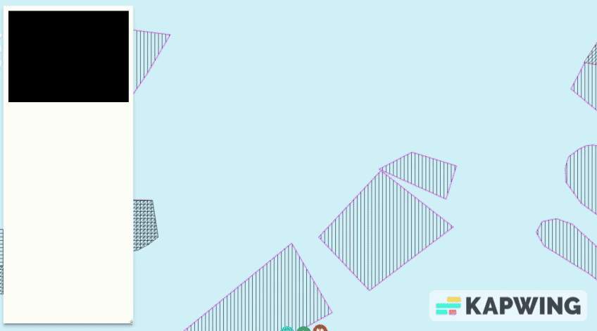

When I add a feature via the FeatureServer, sometimes* it is not immediately available on the MapServer.
*- sometimes means for some users on some zoom levels.
See the GIF below.
The feature that's disappearing and reappearing is from a MapServer (there are other features around it from the same service). It was added via the FeatureServer a few minutes ago. Onclick, we call queryFeatures so that's why it shows (queryFeatures/selectFeatures always uses latest data). To force the freshly-added features to show after they were added, I call .refresh() on the layer that points to the MapServer. As you can see, works sometimes.

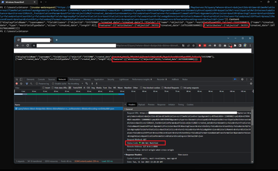

Here I have created an example. The query contains an envelope which currently encompasses 2 features. To recreate my problem:
  1. I called the query in Chrome, got 1 feature (expected)
  2. I added another feature (geometry within the geometry of the old feature to ensure it will show up in the same query)
  3. I call the query in Chrome again, MapServer returns 304 Not Modified, giving me the 1 feature (I expected 2 features)
  4. I call the same query in PowerShell, sure enough I can see 2 features.
I can repeat step 3 over and over with the same result
ViktorSafar
I believe I narrowed it down to the browser request having an If-None-Match header with "0" as its value. From what I read that value should be unique and this does not appear to be a very unique value. How is this set by the JS SDK?
