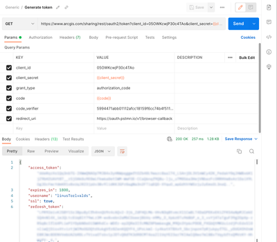

It was because I was sending the in the "code_verifier" parameter "12345". Reading again the doc again I noticed:
The first step in the PKCE modified workflow is having the application create a code verifier. The code verifier is a cryptographical string using alphanumeric characters (A-Z, a-z, 0-9) and punctuation characters (hyphen, period, underscore, and tilde). A code verifier string should be between 43 to 128 characters long.
So I encoded 12345 with this online tool getting the following hash: "5994471abb01112afcc18159f6cc74b4f511b99806da59b3caf5a9c173cacfc5"
Then I tried again and it worked:
I prefer to use Postman to get familiar with any APIs before I start writing code. But I hope this helps.
