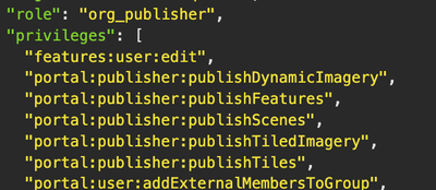

I do have those privileges assigned:
And using the same token as a `token` parameter in the request, rather than in the header, works.
