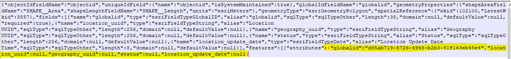

How to make post request to update these field and send these four attribute values as json data, I am trying to send like this but values are not updating.
payload = {
    "updates": [
            "attributes": {
                "globalID": "<Your_GlobalID_Here>",
                "location_uuid": "<New_Location_UUID>",
                "geography_uuid": "<New_Geography_UUID>",
                "status": "<New_Status>",
                "location_update_date": "<New_Location_Update_Date>"
