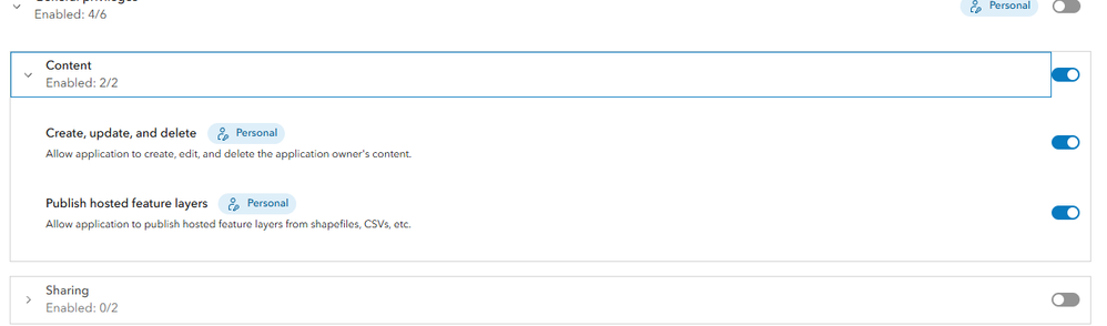

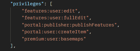

devdattaTH
That is one of the first things I checked, and the key does have both the permissions.
