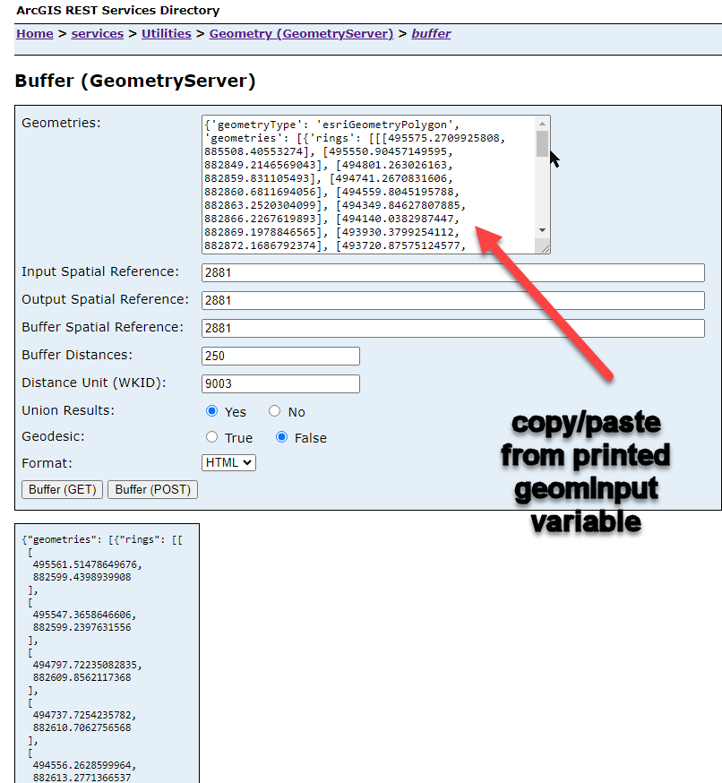

Having some difficulty with a post request to our ArcGIS Server buffer utility endpoint and coming up with this response when executing in python requests, but running the same exact input parameters on the Utilities/Geometry/GeometryServer/buffer REST page it works. Error message:
{'error': {'code': 400, 'extendedCode': -2147024809, 'message': 'Invalid or missing input parameters.', 'details': []}}

Here's the input Geometries parameter "geomInput", that comes from an initial request to a service layer on published on the same ArcGIS Server site, SR 2881:
{'geometryType': 'esriGeometryPolygon', 'geometries': [{'rings': [[[495575.2709925808, 885508.40553274], [495550.90457149595, 882849.2146569043], [494801.263026163, 882859.831105493], [494741.2670831606, 882860.6811694056], [494559.8045195788, 882863.2520304099], [494349.84627807885, 882866.2267619893], [494140.0382987447, 882869.1978846565], [493930.3799254112, 882872.1686792374], [493720.87575124577, 882875.1355368197], [493511.52183924615, 882878.1017382368], [493302.3175332472, 882881.0643307418], [493082.0259790793, 882884.1853874922], [492918.59684399515, 882886.4980469048], [492922.98856749386, 883580.9809099063], [492889.98830541223, 883581.418573074], [492893.9925624952, 884214.7765583247], [492860.99295657873, 884215.2056913227], [492810.41759841144, 884215.8598894924], [492562.22616566345, 884219.0767465755], [492395.6389004141, 884221.2348787412], [492229.02637274563, 884223.3933389932], [491895.8219866641, 884227.7141964883], [491562.6179286614, 884232.0347259045], [491229.4181357473, 884236.3516464084], [491022.93068782985, 884239.0265098214], [490563.0139567442, 884244.9890963212], [490228.3850328289, 884249.3266860768], [489896.68097182736, 884253.6265462413], [489730.08091132715, 884255.7850064933], [489563.4769138284, 884257.9474037364], [489568.5769692473, 884889.7184499055], [489574.1684934944, 885582.6845836565], [492902.3800129108, 885541.4887999073], [495575.2709925808, 885508.40553274]]]}]}

Ok looks like the geometries input parameter is not expecting loaded json objects. The solution is to pass in the json.dumps() of the geometries:
