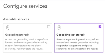

Hi @herasey,
This request is working for me:
https://geocode-api.arcgis.com/arcgis/rest/services/World/GeocodeServer/findAddressCandidates?token=MY_API_KEY&f=pjson&singleLine=1600%20Pennsylvania%20Ave%20NW,%20DC&forStorage=false&maxResults=1
It sounds like your API key is not configured correctly (API key configuration panel).
Note: any changes on that configuration can take up to 10min to propagate across the different servers
Maybe you can test it using the Geocoding Postman collection we made available.
I hope that helps.
herasey
nope. It's configured properly. it was working for over a day, so i highly doubt that would be the issue. Still, all I get is "token is valid but access is denied" because it assumes I am storing results.
