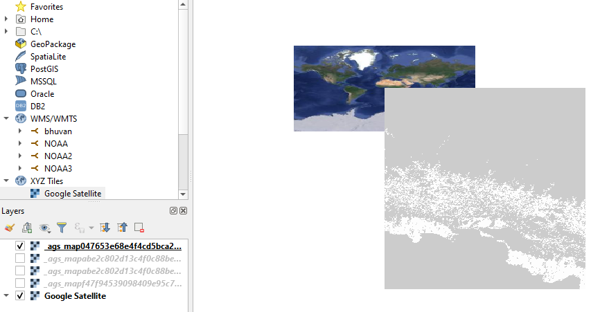

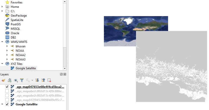

Despite the native projection of the data and the specified projection of this TIFF being 4326, loading the exported TIFF file in QGIS , it doesn't appear to be spatially referenced.
Any insight as to what I am doing wrong or how to ensure the the export TIFF is georeferenced?  I have a sneaking suspicion that the exported TIFF is not a GeoTIFF, and that there are some additional steps necessary to append the projection data, but I haven't been successful in finding a way to do this.

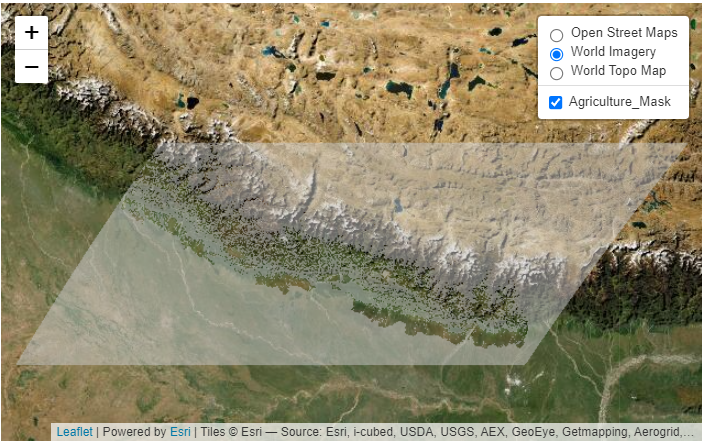

By the way, in case you're interested I have an Observable notebook where I've played around a bit trying to load these data into the browser and render them... with varying degrees of success:
https://observablehq.com/d/91242af9f27c631b
ESRI Leaflet will render the layer using just the defaults:
