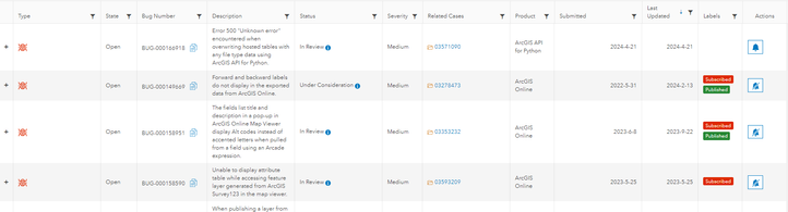

Here is the latest update:
The outcome of the escalation was Esri Inc. logging the following defect:
BUG-000166918: Error 500 "Unknown error" encountered when overwriting hosted tables with any file type data using ArcGIS API for Python.
A workaround for this issue is to use a File Geodatabase to append data to the table instead of GeoJSON (or CSV).
