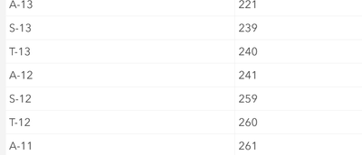

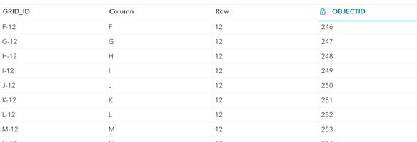

That would be very troubling if so. I've got a few "testing" layers I keep around for things like this, so here goes:
Parent Layer: 4 fields, objectID 250 is presentParent Layer: 4 fields, objectID 250 is present
View Layer: No objectID 250, only 2 fieldsView Layer: No objectID 250, only 2 fields
For testing, I'm going to use ObjectID 250.

So, that's alarming. But let's double check the parent layer.
Sure enough. Remember, that objectID wasn't present in the view layer from a query. And what about attributes that aren't in the view?

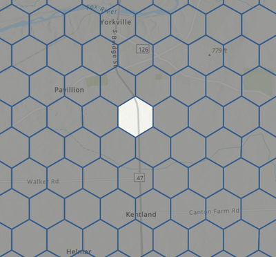

Delete the Feature
I think I know how this one ends, but let's test it for the sake of being thorough.
There's where it use to be.
