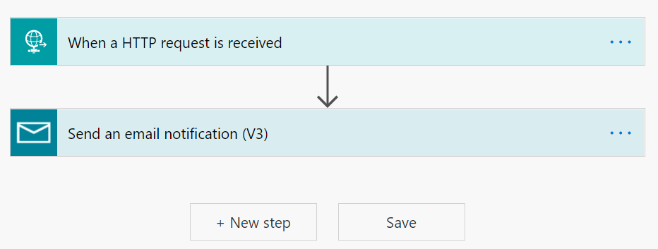

I'm trying to set up a webhook in ArcGIS Online that will send an email when a feature has been created in a hosted feature service. I do not have portal/enterprise, so the only example that I have found is setting the webhook up with Integromat.  We have o365 and I would like to use Power Automate (MS Flow) to send the email.  I've been trying to follow the MS Flow steps in this example, but without success.  I copied and pasted this sample into my JSON payload:
{ "layerId":0, "serviceName": "myService", "changeType": "FeaturesUpdated", "orgId": "myorgId" "changesUrl": "https://olserver/services/myService/FeatureService/extractChanges?serverGens=[1122, 1124]" }
Which creates the following in 'When a HTTP request is received' (code view):
    "kind": "Http",
    "inputs": {
        "schema": {
            "type": "object",
            "properties": {
                "layerId": {
                    "type": "integer"
                "serviceName": {
                    "type": "string"
                "changeType": {
                    "type": "string"
                "orgId": {
                    "type": "string"
                "changesUrl": {
                    "type": "string"
I then have the next step to send an email to my email account.
I added the hookurl to my webhook with "ChangeTypes" = FeaturesCreated.  The webhook created successfully, but no email is sent when the hosted feature layer has a feature added to it.
If you have done something similar to this workflow, any guidance would be much appreciated!!
