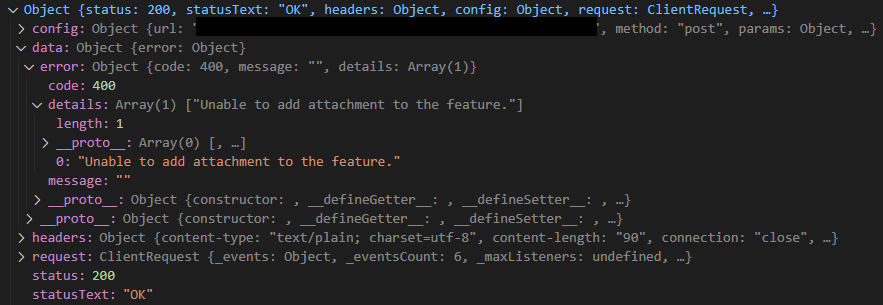

  Hi,
 I'm trying to add an attachment via a REST request in Node JS but it give me an error with code 400 and     message "Unable to add attachment to the feature.". The layer is hosted in AGOL and has attachments enabled. Via AGOL I can add and delete attachments without any issues. I'm using form-data to add the attachment on the REST request.
Screenshot of error:
Code Snippet:

Any ideas of what is wrong in the request that is causing the error "Unable to add attachment to the feature"? 
