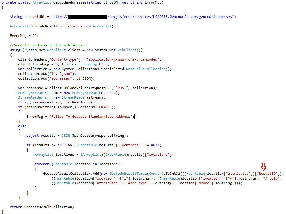

The geocoding was fairly easy, I’m sending batches of addresses to the geocode server that was made available by our GIS guys and when
the results come back I get a resultID back which is my unique identifier for each record. Here is a sample of the JSON string I send in to my code:
{records:[{attributes:{OBJECTID:1134,Address:123 Test St,City:Testville,Region:PA,Postal:12345}};{attributes:{OBJECTID:294302,Address:12 Fake Rd,City:Some
Town,Region:PA,Postal:54321}};]}

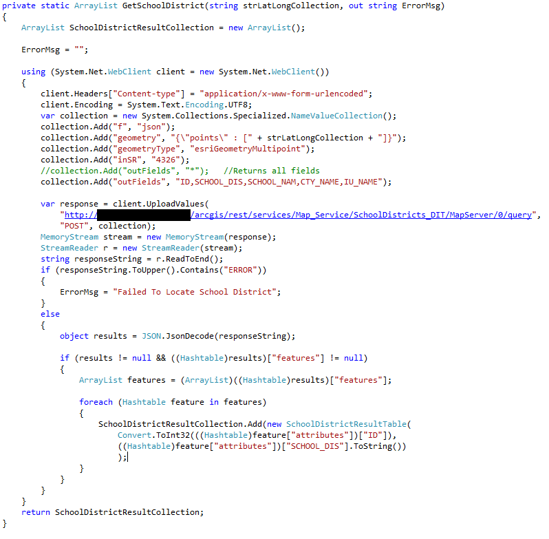

The problem I am running in to is when I try and query additional information (like school district in this example) for the returned
latitudes and longitudes. I can get it to work if I send the latitude/longitude one at a time using esriGeometryPoint for the Geometry Type. But this would require me to make 20 million calls to the ArcGIS server and I really want to avoid that. It would be much faster if I could send batches of lat/long points to the server like I did for the geocoding. I had some success changing the Geometry Type to esriGeometryMultipoint and I do get multiple records back but I cannot find a way to pass in and return a unique identifier for me to know which returned school district goes with which latitude/longitude. Also, if I happen to pass in an invalid lat/long it skips this record so my return count is different than the number of records I sent in.
Even if there was no unique identifier available, I could work with the original lat/long that was sent in. Unfortunately, this is not returned either. Here is my code and a sample string of lat/longs for the strLatLongCollection variable:
[-77.1111236737177,40.3156937711517],[-75.8130555653613,40.1077510928398]

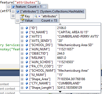

Here is a sample of my returned data when I ask for all columns to be returned. Neither the “ID”, “OBJECTID” or “IU_NUM” are helpful.
They all relate to the returned school district, and not the lat/long I sent to the server.

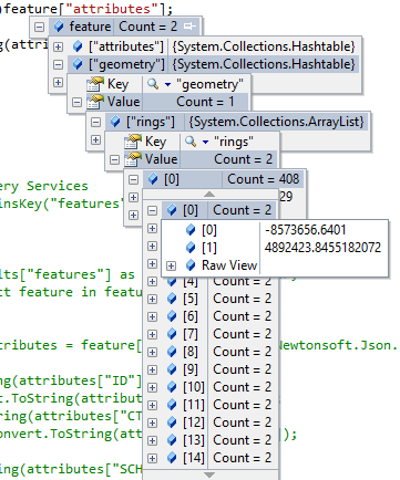

I also tried returning the geometry with the results. I’m not sure what “rings” are but none of the values are associated to the lat/long I sent to the server.
