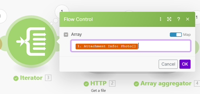

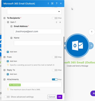

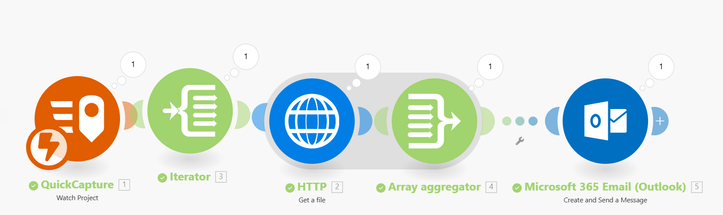

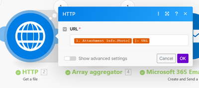

The following scenario will add the attachment to an email:
Configure the QuickCapture module to point to the appropriate QuickCapture project/layer.
Iterate through the attachments in the webhook payload:
Make a HTTP (Get a file) request to get the attachment(s):
Use an Array aggregator to aggregate the attachments, using the Microsoft 365 Email (Outlook) - Create and send message Target structure type. Use the HTTP - Get a file for the Attachments=>File option.
Set the aggregator output as the Attachments property.
