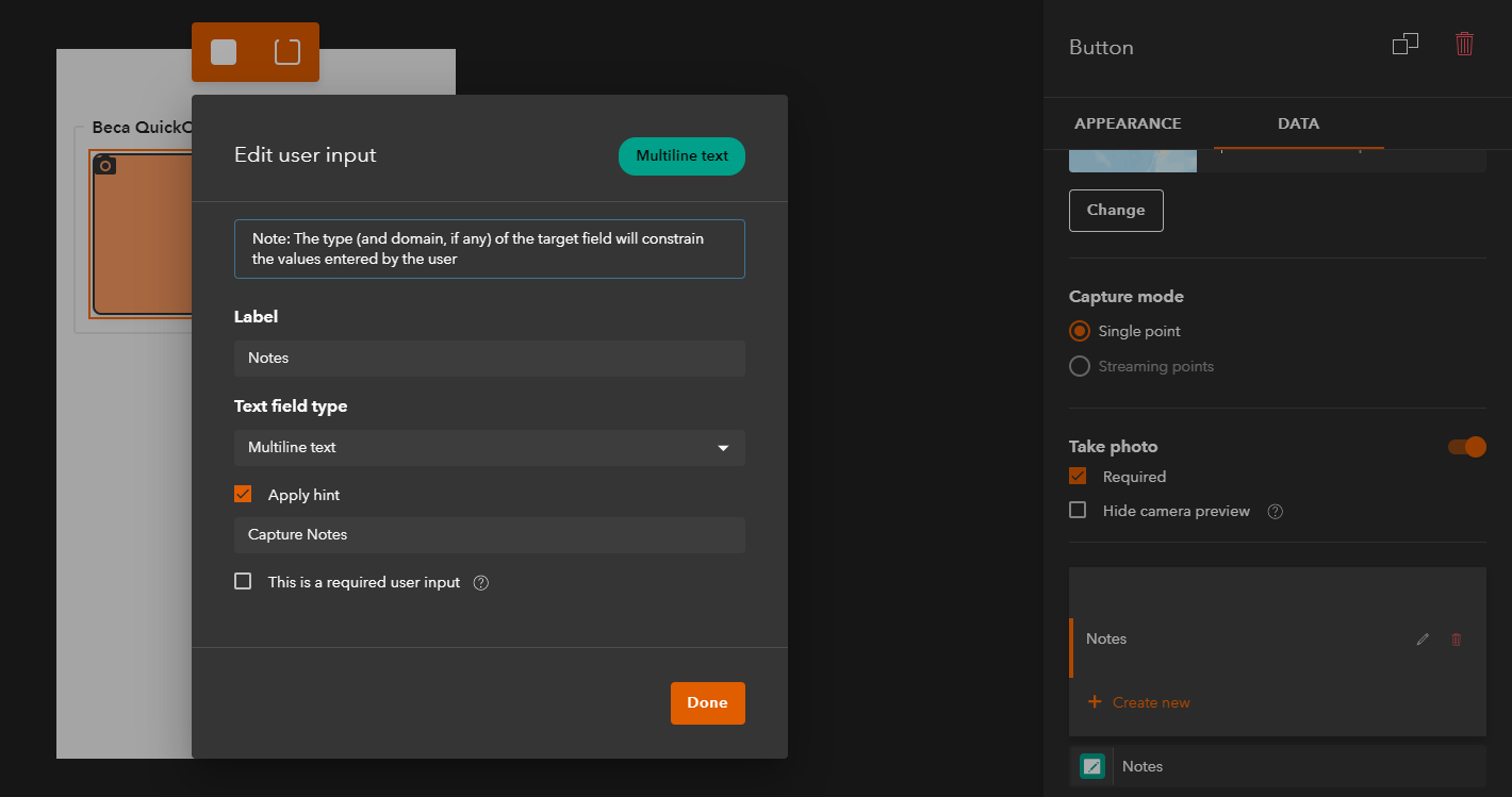

We have a QC project built with user input applied to a button to capture notes.

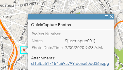

If the user skips the notes then a default value of ${userInput:001} is captured to the attribute.

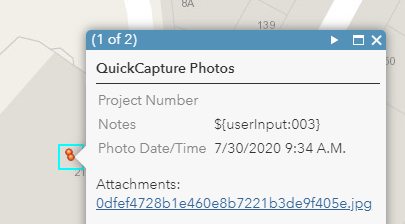

I just created a new user input value and it does the same thing but with a different default value:
I don't think this used to happen.

I can confirm that this is a bug with button user inputs. If the user input is not required and no value is entered, the app is entering an internal string into the capture record. We will get this fixed in 1.7 (and in the short term get a build on Early adopters community - I'll paste the link here when this is ready).
