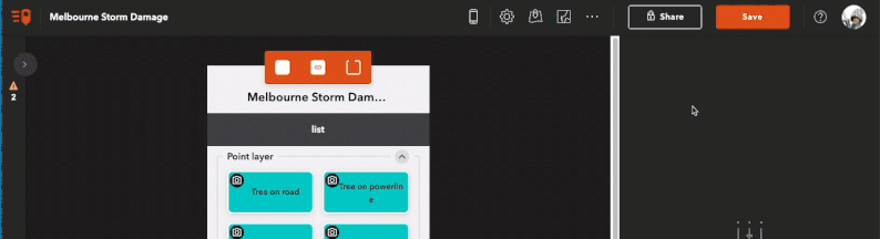

We will be adding a new property to the project JSON in version 1.13 (due March 2021), to address this issue. If you go into the JSON editor and change the value for the featureRequestMode property from onInteractionNoCache to onInteractionCache (and then save the project) you will no longer see the issue.
However, making this change means that there will be a slight lag in web map updates when online. It can take a few seconds for any newly submitted features to appear.
In a future release we will make this a setting in the designer, so you wont need to do this manually.
