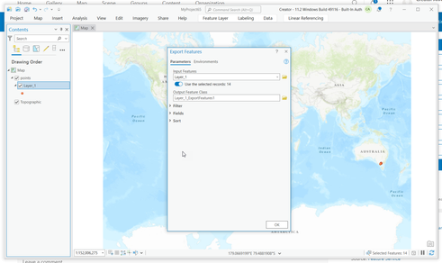

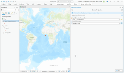

If you have data in the wrong place, here are the steps to correct it:
The bug relates to Enterprise version prior to 11.3 ignoring the spatial reference being provided by QuickCapture. QuickCapture captures data in the Geographic Coordinate System: WGS84. However, enterprise thinks that the coordinates are in the projected coordinated system: WGS 1984 Web Mercator (Auxiliary Sphere).
As the coordinates are still being captured, the data can be corrected using the following steps in ArcGIS Pro:
  1. Add the affected feature layer to a map in ArcGIS Pro.
  2. Select the features that are in the wrong place.
  3. In the table of contents, right click on the layer and choose Data=>Export features. JohnathanHasthorpe_0-1736383272609.pngJohnathanHasthorpe_0-1736383272609.png
  4. In the new layer that is created, run the Define Projection tool on it. Make sure you set the Coordinate System value to GCS_WGS_1984.
  5. This will move the local features to the correct place. The next step is to use the Append tool to write these features to the original feature service:
  6. JohnathanHasthorpe_4-1734733148012.pngJohnathanHasthorpe_4-1734733148012.pngThe final step is to delete the points in the wrong place from the original feature layer if desired.
I hope this helps.
