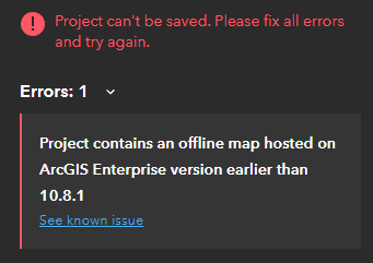

I am trying to get a MMPK to work with our Quick Capture projects for offline use. I followed the instructions in https://support.esri.com/en/technical-article/000022755.
When I either edited the json OR simply used the mmpk as the linked map I got the same error in the Quick Capture Designer and wasn't able to save it.
Our company does not use Enterprise, I created it in Pro 2.7. I uploaded it to AGOL using the Add New items button and simply selected the created mmpk from my computer and uploaded.  Is there a different way to upload this to AGOL so that it works or is this a bug/error and I need to find a different work around (i.e. sideload to device) to get this mmpk available for use with Quick Capture?
Mandy_Li
@AmeWunderle @Jordan_Smith Issue has been resolved, please try again.

Having the same issue (Everything completely hosted on AGOL), using a workflow that was working for the past 18 months. Same Questions. Is this a bug or designed compatibility issue to a new workflow. I have submitted a ticket and was advised to sideload mmpk which is not supported in QC... So no workaround advised yet.
Mandy_Li
Hi, this is a bug, we will address it as soon as we can. Thanks for reporting this.
Mandy_Li
AmeWunderle
Thanks Mandy. I added the mmpk as the Map for my Quick Capture project without any issue now.
