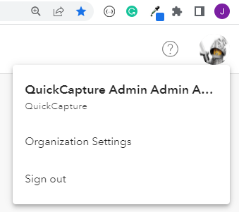

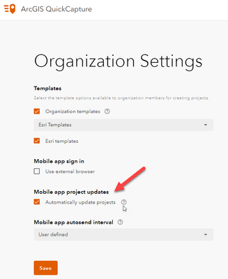

There is a setting in the designer that enforces the automatic update of projects. You will need to sign in as an ArcGIS user that is an administrator and you will see organization settings:
Once the user closes the project, it should automatically update.
However, as the user is outside of your organization this setting will not work for them. Unfortunately, there is no way to automatically force project updates if the user is in another organization.
