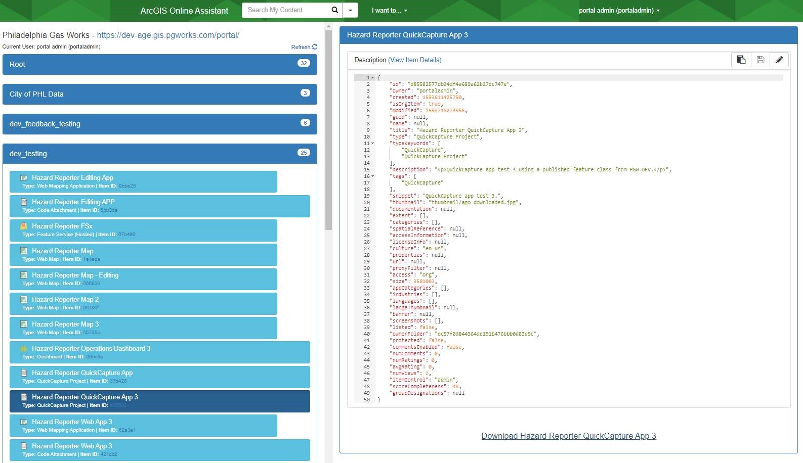

For other Portal items, we are using https://ago-assistant.esri.com/# successfully to migrate layers, maps, and apps by copying the items from lower to higher environments and then updating the JSON of the various items. That option isn’t available from the JSON for QuickCapture projects and nothing happens when I click the download link.

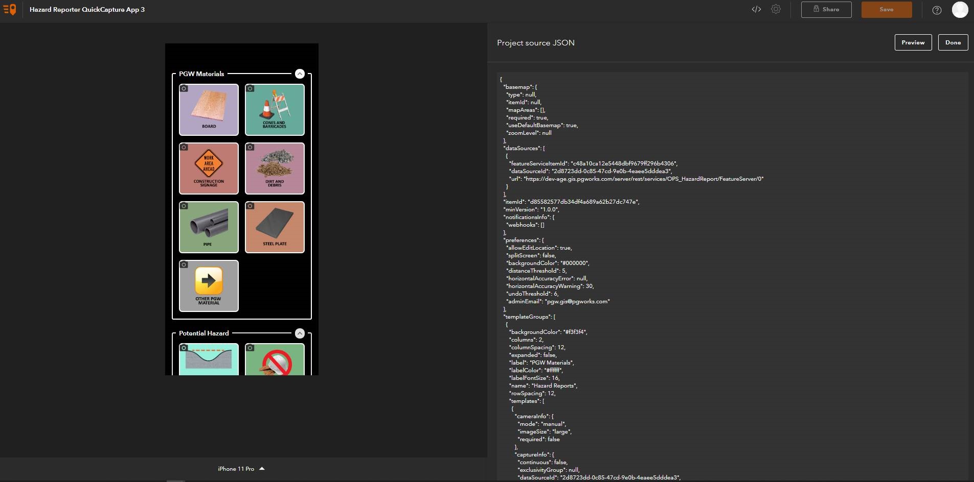

I tried copy/pasting the Project source JSON from inside of the QuickCapture Project Builder UI from Dev into a newly created blank project in a higher environment and then modifying the text at the beginning of the section of code, but that didn’t go well as it didn’t carry over images that were used.
