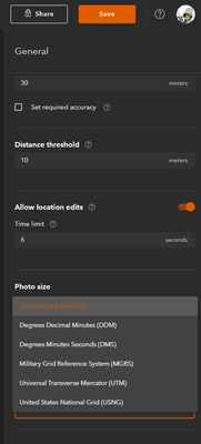

If you want to change the coordinates displayed in the app, you can update this in the projects general settings:
Thanks
John
