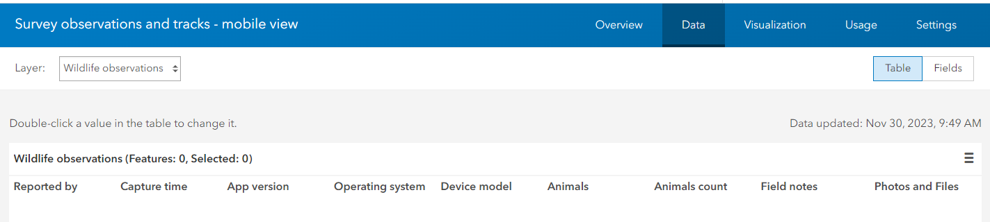

I've created a Quick Capture project from the "Rapid Wildlife Reporter" template. When a user clicks on a button to report that they've seen a particular animal - e.g., a moose - there are 2 more fields for users to fill out, "Animals count" and "Field Notes":
The fields are in the same order in the data view of my hosted feature layer view:
But when I go into the mobile app and press the "Moose" button, the user sees "Enter field notes" before "Count". This happened after I updated to the beta version of the app (1.18.85). I think 1.18 stable release comes out tonight, so I'll try again with that release... but... does anyone have any idea how to change the order of these capture fields?
