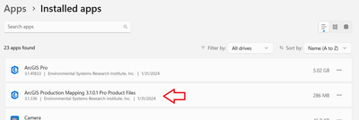

DanHopkins
Hi @Angiex__1
Do you have an entry for ArcGIS Production Mapping 3.1.0.1 Pro Product Files  in the Installed apps on your Windows 11 machine? Please see screenshot below:
If yes, did the product files get installed to C:\Angie\Documents\Data or C:\Users\Public\Documents\ArcGIS Production Mapping or somewhere else?

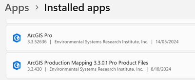

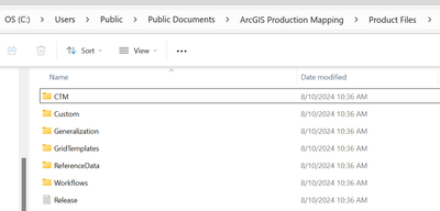

GeoffHodgson_FSA
Hi @DanHopkins
I found this thread after having issues activating the Production Mapping extension, but didn't see the resolution that fixed @Angiex__1's  issue.
I installed to the default directory :
.. and can see that the app is installed :
.. but the extension is still greyed out in ArcGIS Pro :
Am I missing a step here somewhere ?
Thanks, Geoff
DanHopkins
Hi @GeoffHodgson_FSA
Thank you for providing the screenshots.
The 'Licensing' screenshot indicates that your License Type is set to Named User License. If your license type is Named User, extension licenses are assigned to users by the ArcGIS Online or ArcGIS Enterprise organization administrator. Production Mapping Licensed = No indicates that the extension license is not assigned to the user.
