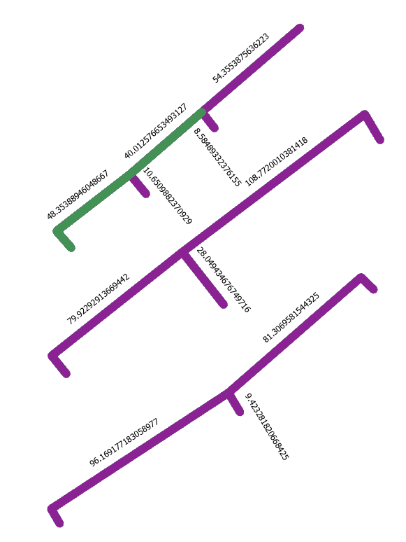

Hi all,
Regarding the Remove Small Lines tool, I get odd results. I've tried multiple parameters (angles of 20, 45, 90,...), with arcpy, with arcgis pro, various data editing (reverse lines, remove unnecessary vertices,...). The only thing that makes it work as intended is by removing the smallest lines.
It might be user error, I might be missing something crucial. It seemed pretty straightforward tough.
Here are the results in green, purples are the original lines (labels are length):
 Minimum length is 150 Meters, maximum angle of 90 and 45 gives the same result. Everything snapped and split at intersection,...
 Any idea?

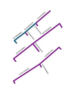

Arnaud_IGN
Thanks for the suggestion, Dan.
The results are (again) weirdly the same (now in blue):
 The only lines that are kept add up for less than 100m, so I can't figure out what's happening here. This has to be something I'm missing as the results are so far from what's expected.
