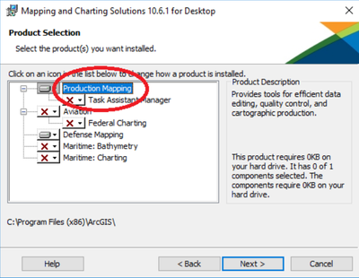

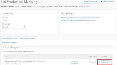

The same applies for ArcMap as well. Irrespective of the level of ArcGIS Desktop (ArcMap) license, you need to have Production Mapping License for Desktop.
Then, you need to install Esri Production Mapping 10.6.1 (Mapping and Charting Solutions for Desktop) from My Esri.
And install the required component
It should then be available under Customize > Extensions in ArcMap.
