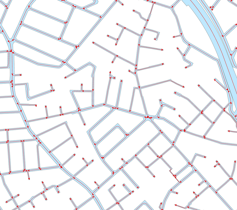

I have generated road centerlines from dissolved road polygons. I've observed that some centerlines are snapped to the corner of dead-end roads, while others are snapped to the midpoints. This behavior persists regardless of whether I set {connecting_features} as the dissolved road polygons.
Here is an example:Polygon_To_CenterLine_Capture.png

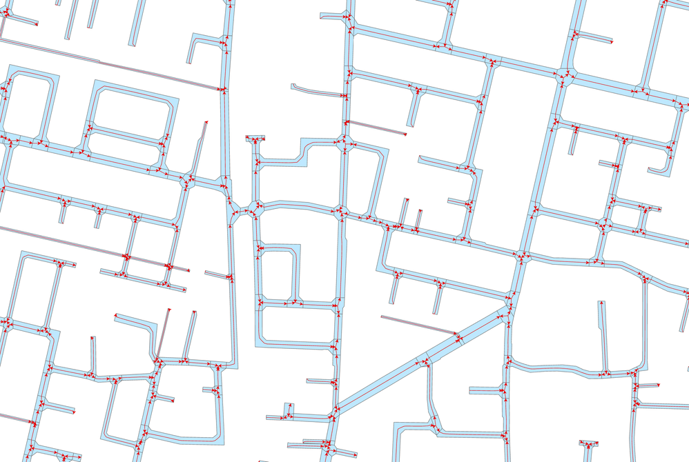

I run it on the original data set and compare the results with the densified polygons. Here are my findings as following:
1. It's incredibly fast! The process took only 1 minute and 48 seconds for 129,222 original road polygons. In comparison, the Polygon To Centerline tool took 2 minutes and 54 seconds for the dissolved road polygons (not Densified).
2. Collapse Hydro Polygon tool created more centerlines which were positioned to corners other than the centers of road polygons compared to the Polygon To Centerline tool.
3. The Polygon To Centerline tool created better centerlines in the intersections than the Collapse Hydro Polygon tool did.

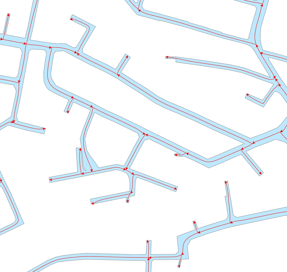

After densifying the original 129,222 road polygons by 2 meters, the results significantly improved compared to without densification.
Here are my steps to create the centerlines from the road polygons.
1. Launch the Densify geoprocessing tool on the original road polygons, setting the distance to 2 meters.
2. Use the Select tool to extract the non-intersection road polygons.
3. Launch the Collapse Hydro Polygon tool to generate centerlines for non-intersection road polygons.
4. Use the Select tool again to extract the intersections within the road polygons.
5. Launch the Polygon To Centerline tool to create centerlines for these intersections.
6. Merge the centerlines of intersections and non-intersections.
7. Use the Select Layer By Location tool to identify centerlines whose start or end nodes align with road polygon corners.
8. Use arcpy.da.UpdateCursor to trim the first or last 5-10 vertices of incorrect centerlines.
9. Use arcpy.edit.ExtendLine tool to extend any incorrect centerlines to the road polygon boundaries.
Here is an example of Collapse Hydro Polygon tool for 2m-Densified road polygons:
