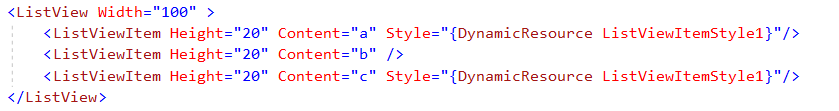

With SDK 2.5 I add a new DockPane to my addin module, and put a listview on it with some listviewitems.

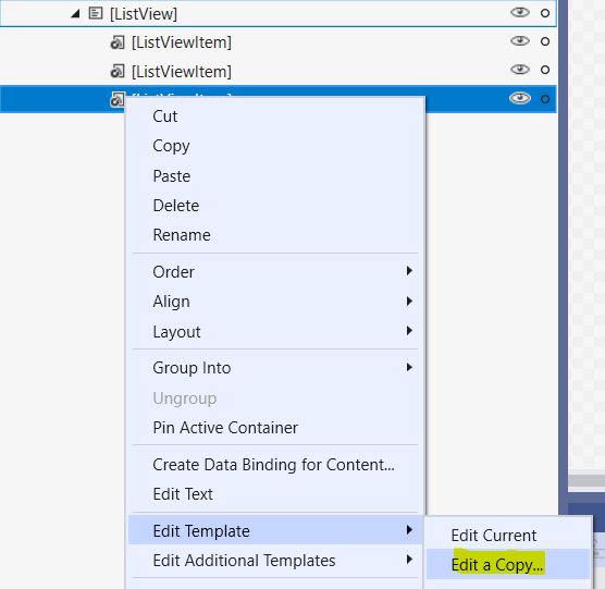

In the document outline I right click and choose add a copy ...
I remove the style from the middle item ...
I see it at design time ...
But not at run time ...

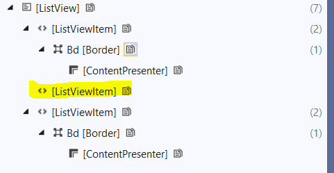

At runtime the visual tree for the middle listviewitem  has no children ...
