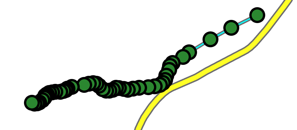

Hi,
I'm trying to find lines on which there are points that I would then connect into a line. The problem is that as soon as I look for points intersecting the line, it doesn't find any even though I know they must be there.
One line example
my code:
 if (!(MapView.Active.Map.FindLayers("Z_Voda_L ").First() is FeatureLayer vodaLayer))
                return;
   FeatureClass fcVoda = vodaLayer.GetTable() as FeatureClass;
 if (!(MapView.Active.Map.FindLayers("featureToVer").First() is FeatureLayer featureToVer))
                    return;
                FeatureClass fcFeatureToVer = featureToVer.GetTable() as FeatureClass;
 var qfilter = new QueryFilter
                    WhereClause = "OBJECTID >= 0"
  var vodaPruchod = fcVoda.Search(qfilter);
 while (vodaPruchod.MoveNext())
                    var vodaFeature = vodaPruchod.Current as Feature;
                    var body = vodaFeature.GetShape() as Polyline;
                    var spatialQueryFilter = new SpatialQueryFilter()
                    { FilterGeometry = body, SpatialRelationship = SpatialRelationship.Intersects};
                    var polyCursor = fcFeatureToVer.Search(spatialQueryFilter, false);
                    var mapoveBody = new List<MapPoint>();
                    while (polyCursor.MoveNext())
                        var bodAktual = polyCursor.Current as Feature;
                        var mapPoint = bodAktual.GetShape() as MapPoint;
                        mapoveBody.Add(mapPoint);
The polyline is always selected because I see it always has a length, but I don't know why it doesn't find any point.
I will be glad for any advice and help
David

GKmieliauskas
Hi,
 Somethimes spatial filter doesn't work if spatial references of FilterGeometry and FeatureClass differs. Then you need to reproject FilterGeometry
DavidMrázek
I'm probably asking a stupid question, but how is it done?
GKmieliauskas
Project or check spatial references?
To project use code like this:
var sr = fcFeatureToVer.GetDefinition().GetSpatialReference();
FilterGeometry = GeometryEngine.Instance.Project(body, sr);
To check spatial references place breakpoint near spatialQueryFilter add body and fcFeatureToVer to VS watch list and investigate
