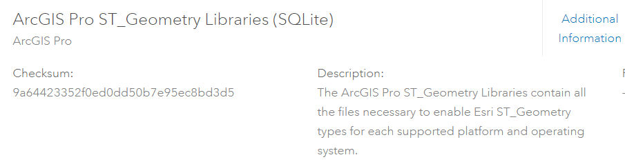

It turns out the dlls from MyEsri are actually Sqlite extensions, even though Esri doesn't call them that.
Dlls for Windows and linux can be downloaded from MyEsri under Database Support.
I'm able to call SqliteConnection.LoadExtension, passing the path to the dll, and then query the featureclass with ST_AsText.  Except for the dll, there are no other Esri dependencies.
SELECT ST_AsText(shape) from MyPolygons
I'm assuming that all the ST_Geometry functions described here will work with only the dll, but have not verified.
