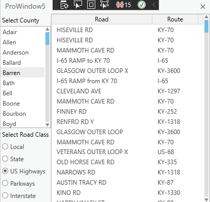

I have utilized a ProWindow which shows road names and route numbers for selected county and road type
Altogether I need to read about 350K - 400K rows ( all feature counts local, state, etc. ). I tried a few different strategies to load them faster.
The best way I found: I created dictionaries for each feature class ( local, state, highways ..) which are filled from reading attribute tables after initialization of the ProWindow. Whenever a user selects a feature class and county that dictionary filtered and transferred to ListView items source. However, initialization takes more than a minute

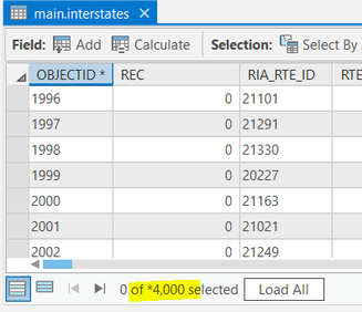

Have you considered just loading chunks of items?
E.g. Esri loads 2000 rows at a time into the attribute table. Scrolling to the end triggers an event to load the next 2000.
Linq provides helpful methods.  To use them you could implement IEnumerable.

I thought about that but I thought it would be too complex to implement, I will check your click and see what I can do.  Thanks!

Users have to narrow down the search by selecting county and road type. I am using that criteria to narrow down the search and update ListView.ItemsSource which displays the results.
Initially building dictionaries taking time, querying is very fast but . If I read directly from table into ListView.ItemsSource this time every query has some delays. It is because a large table get going through in every query.
