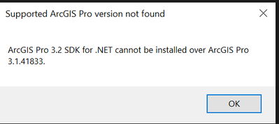

Hi, my ArcGis Pro extension to Visuel Studio have been auto updatet to 3.2. When I try to add a button in a project created with 3.1, I get this message:
I dont have ArcGis Pro 3.2 installed.
Is it possible to downgrad the extension i VS to 3.1?

There is no direct way to downgrade to 3.1. You need to uninstall extensions then download old versions from Esri site and install from vsix files. Then you need to uncheck automatic update of ArcGIS Pro extensions

I had to do that last week, and it took a while to find the VSIX files. They're in the 3.1 section under Assets on https://github.com/esri/arcgis-pro-sdk/releases

Thank you both, It worked for me 🙂
