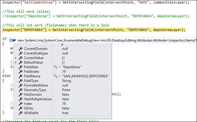

In ArcObjects, using the highlighted names always worked, but in ArcPro they all worked except for DEPOTAREA.  So I am using the Alias now, but in the documentation for the Inspector class it just says to use the 'Attribute Name'.  Is it really case-sensitive??
Hi Brian.
Yes the inspector key is case sensitive. It looks for either the field name or field alias.
Before the join, “DEPOTAREA” works because that’s the field name.
After the join, the inspector FieldName becomes “Table.FieldName” or “SAN_MANHOLE.DEPOTAREA”.
Therefore "DEPOTAREA" is no longer found in either the field name or field alias.
In the previous line, “SettlementArea” works before or after the join as that’s the field alias. "DepotArea" would also work for the same reason.
We'll get this addressed for 2.3 where they key will be case insensitive. Thanks for sending the data.
