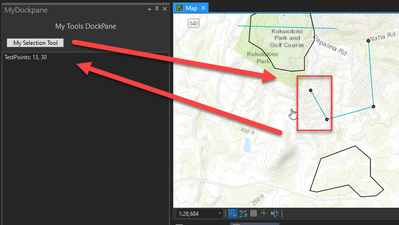

I attached a sample with a tool that is instantiated from a dockpane and reports the selection results on the dockpane:
