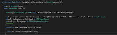

Hello everyone, I have encountered some problems on gis pro. I want to use maptools to get the label name of the currently selected feature, but I can only get the collection of the feature layer label class.
thanks
