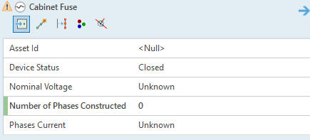

I'm having some difficulty using the AddAttributeAsync() method on the Inspector class. I have tried with different sets of attributes but I can never get the embeddable control to render the fields I have added, it only renders when I have loaded a full layer schema or a mapmember and objectId.
Could anyone provide a sample that shows proper usage of this method? I was presuming it is this call that would provide for displaying a subset of attributes for modification much like the Create Feature experience shows. I didn't see any usage of this method in the community samples projects.
 Create Feature dialog showing subset of all fields

The solution does help. It shows how to edit attributes using the AddAttributeAsync Method.
However, it does not solve the original problem. How do you display only a single field or fields in a inspector without loading all the fields and values?
