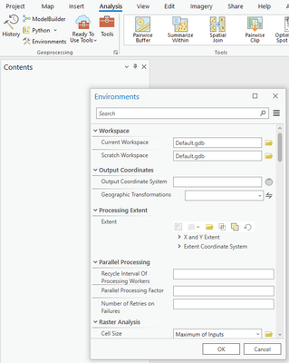

It isn't he system environments variables I'm seeking - it is the list of environment settings in ArcGIS PRO found under the analysis TAB:
It is pretty easy in Python but how do I set these using .net ?

That is when you want to use the setting, but how do I change a setting and save it in the my project?
CharlesMacleod
Gotcha. it's not supported. i'll take this as a new requirement for GP

@CharlesMacleod is correct that there is not a way through the Pro .NET API to change or set Geoprocessing Environments for your project. @pocalipse can you explain what your intention is for having an Add-in or Extension or other SDK element setting the project Geoprocessing environments? @CharlesMacleod mentioned the MakeEnvironmentArray function, which you can use to set all of desired environment settings, then reuse that environment array for any tools you run using ExecuteToolAsync, so the effect can be quite similar to setting the environments to the project. For example (pseudo code)
