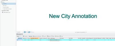

StåleHaug
Thanks for your your feedback!
Changing the textstring works, but not the first time the functionality is used. Then the textstring is only set to 'Text'. I have also tried to hardcode a textstring like you do
annoProperties.TextString = "PleaseDontBeText";
but the same still happens. I have no idea why, this has never happened before.
I have tried running isolated code like you do in your sample, and then this is not a problem. But we have also several other tools, that picks out attributevalues from features and turns them into annotations (for example, taking the altitude attribute of a lake feature and creating an annotation out of it). Then the problem is still there, the first time the code is run the textstring is set to 'Text' and not the altitude value.
We have had this code running for years, through various editions of Pro (both 2.x and 3.x), and this started happening with version 3.5.

I tried creating a new annotation feature class — it's working, could you please explain"but not the first time the functionality is used"

StåleHaug
Once again, thanks for all the help and the effort you make. It is greatly appreciated.
When AG Pro is started, and editing is started for the first time, the resulting textstring is always ‘Text’. See ‘name_test1.png’. The textstring should have been ‘Skolo’. From there on it seems to be random whether the textstring is ‘Text’ or correct. See ‘name_test2.png’. If I discard all the edits, and starts creating the same annotations once more, everything is correct. See ‘name_test3.png’.
But if I restart Pro, and start editing again by creating the same annoations, the same happens once more. The first annotation is always ‘Text’, and from there it is random if the textstring is ‘Text’ or correct. See ‘name_test4.png’.
There is a lot going on in my code, from calculating annotation geometry with the correct angle to collecting a lot of information from the place name registry layer. It could be this is the problem, creating an annotation by just doing
annoProps.TextString = "New City Annotation";
 works correctly for me too.
I hope this explanation was 'understandable'. Like I said, up until AG Pro 3.4 this worked perfectly.
All data are stored locally on my PC in a file geodatabase.

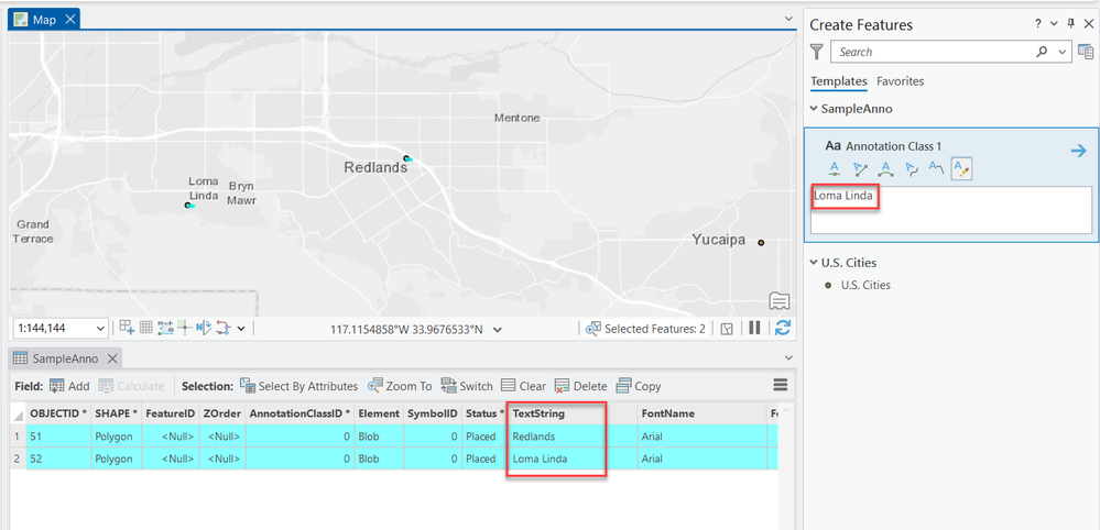

Wolf
by Esri Regular Contributor

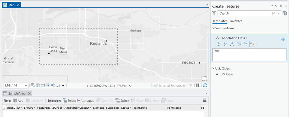

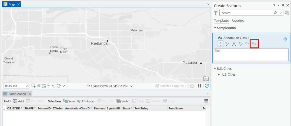

The 'Text' string you're seeing is coming from the annotation editing template.  Somehow, there must be an extra 'createOperation.Create' function call that adds the default template settings to the annotation feature class.  I wrote a sample add-in which is an annotation tool that allows you to select a set of point features (cities in my sample) via rectangular selection and then creates annotation features for all selected point features.
I attached the sample code and also the project file i used for testing.  Maybe you can compare the sample code to your code and find the difference.   I tested my addin in both 3.4 and 3.5.
To use the sample, open the attached SampleAnno.aprx, use the Create Features dockpane to select the 'Retrofit Annotation for points' tool
and rubber band select a few cities to create the matching annotation strings.

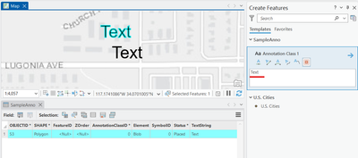

Wolf
You didn't share your tool's OnSketchComplete method.  Is it possible that it contains code to create an annotation feature?   If you create a Construction Tool from the ArcGIS Pro SDK item templates you notice that this code is inserted with the template:
			// Create an edit operation
			var createOperation = new EditOperation();
			createOperation.Name = string.Format("Create {0}", CurrentTemplate.Layer.Name);
			createOperation.SelectNewFeatures = true;
			// Queue feature creation
			createOperation.Create(CurrentTemplate, geometry);
			// Execute the operation
			return createOperation.ExecuteAsync();
this snippet will actually create an annotation feature using the current template (which usually has the string 'Text' as the default value):
My guess is that only a 'Create' call on an EditOperation that is using the current template will produce your 'Text' annotation entry.
Also, if you get the text for the annotation feature from a Query Cursor make sure to 'copy' the text string when you retrieve the string from your current feature.  I would do the same if you get the geometry via a feature cursor, make sure to .Clone() the geometry.
